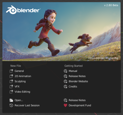

When starting Blender, the splash screen appears in the center of the window. It contains options create new projects or open recently opened blend-files. A more detailed description can be found below.
../_images/interface_splash_current.png
Blender Splash Screen.
To close the splash screen and start a new project, click anywhere outside the splash screen (but inside the Blender Window) or press Esc. The splash screen will disappear revealing the default screen.
To reopen the splash click on the Blender icon in the Top bar and select Splash Screen.
Information Region
The upper part of the splash screen contains the splash image with a lot of key information overlaid.
Title
Besides the Blender icon and text, it shows the Blender version. e.g. the current version is 2.80.
Date
At the top-right corner, you can see the date on that Blender version was compiled.
Hash
The Git Hash. This can be useful to give to support personnel, when diagnosing a problem.
Branch
Optional branch name.
Interactive Region
The interactive region is the bottom half of the splash screen.
New File
Start a new project based on a template.
Recent Files
Your most recently opened blend-files. This gives quick and easy access to your recent projects.
Open
Allows opening an existing blend-file.
Recover Last Session
Blender will try to recover the last session based on temporary files. See Recovering Data.
Links
Links official web pages, the same could be found in the Help Menu of the Topbar. See Help Menü.
Bemerkung
When starting Blender for the first time the Interactive Region contains a Quick Set Up Process.
