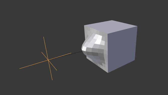

../../../_images/modeling_modifiers_deform_hooks_example.png
Empty used as Hook to deform a subdivided cube.
