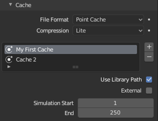

../_images/physics_baking_multi-cache-interface.png
Two different caches stored simultaneously.
Caches List
Blender allows for storing and managing multiple caches at once for the same physics object. You can manage the caches with this list view.
Caches can be added and removed with the Plus and Minus buttons. Renaming a cache can be done by either double-clicking or pressing Ctrl-LMB on the desired cache.
