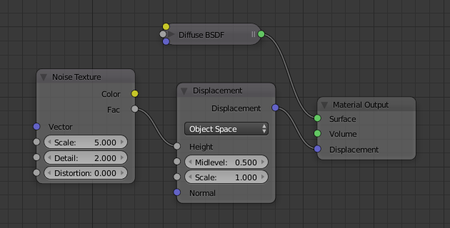

To create displacement, connect a Displacement or Vector Displacement node to the displacement output of the Material Output node. Procedural, painted or baked textures can then be connected to these nodes.
../../../_images/render_materials_components_displacement_node-setup.png
Typical displacement node setup.
