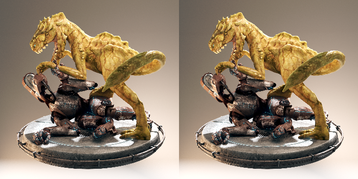

Rendering and Image Editor
Once you are happy with the results, you can render out the final animation. In the Image Editor you can inspect the individual views and the stereo result.
Image Formats
Your final animation can be saved in more robust formats. In this example we saved as cross-eyed side-by-side stereo 3D.
../../../_images/render_output_multiview_usage_render-sidebyside.png
Side-by-side cross-eye format.
