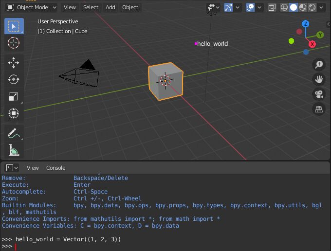

Create a Python Console editor. In the Python Console define a mathutils variable:
hello_world = Vector((1, 2, 3))
You should now be able to see this point in the 3D View!
