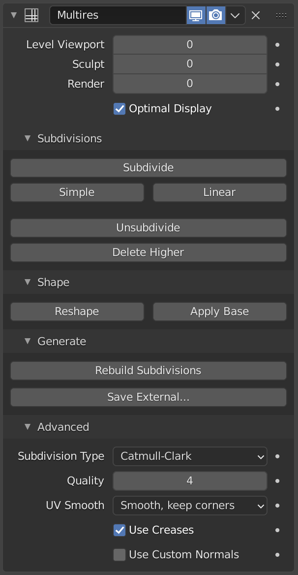

Multiresolution Modifier
The Multiresolution modifier (often shortened to „Multires“) gives you the ability to subdivide a mesh similarly to the Subdivision Surface modifier, but also allows you to edit the new subdivision levels in Sculpt Mode.

Levels Viewport
Set the level of subdivisions to show in Object Mode.
Sculpt
Set the level of subdivisions to use in Sculpt Mode.
Render
Set the level of subdivisions to show when rendering.

Subdivisions
Subdivide
Creates a new level of subdivision using the type specified by Subdivision Type (see below).
Simple
Creates a new level of subdivision using a simple interpolation by subdividing edges without any smoothing.
Linear
Creates a new level of subdivision using linear interpolation of the current sculpted displacement.
Unsubdivide
Rebuild a lower subdivision level of the current base mesh.
Delete Higher
Deletes all subdivision levels that are higher than the current one.
