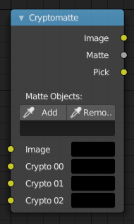

Cryptomatte Node.
The Cryptomatte node uses the Cryptomatte standard to efficiently create mattes for compositing. Cycles and Eevee output the required render passes, which can then be used in the Compositor or another compositor with Cryptomatte support to create masks for specified objects.
Unlike the Material and Object Index passes, the objects to isolate are selected in compositing, and mattes will be anti-aliased and take into account effects like motion blur and transparency.

Crypto Passes
Each crypto layer will be given its own render pass; each of these render passes must be connected to one of these crypto layer inputs. By default there are only four layers, see Adding/Removing Layers to add more.

Add/Remove
Adds/Removes an object or material from matte, by picking a color from the Pick output.
Matte ID
List of object and material crypto IDs to include in matte. This can be used for example to quickly clear all mattes by deleting the text or used to copy-and-paste crypto IDs from other software.
Outputs
A colored output of the input image with the matte applied to only include selected layers.
Matte
A black-and-white alpha mask of the all the selected crypto layers.
Pick
A colored representation of the Cryptomatte pass which can be used with a Viewer node to select which crypto passes are used to create the matte image.
