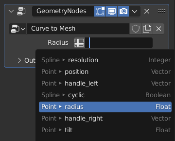

Named attributes are created and used in other areas of Blender like shaders, painting, and UV mapping. In the modifier panel, a named attribute can be used for input by clicking the icon to the left of the value button. The string input input allows you to search and choose existing attributes from the modifier’s input geometry.
Attribute Search.
The attribute search gives a bit of context about each attribute. To the left of the menu, the attribute domain is shown followed by the attribute name. To the right of the menu, the attribute data type is shown.
