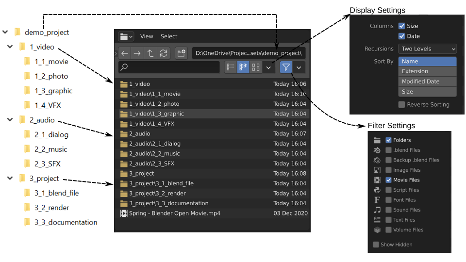

It’s also good practice to use some kind of naming convention and add metadata. Figure 1 shows a possible example, based on our categorization of the assets above. The directories are numbered so that they mimic a normal workflow.
Organizing your project
Figure 1: Organizing your project.
Blender haven’t yet implemented the concept of Bins (virtual directories that only exist within the project). Nor does it have a full-blown asset manager for its video assets. For the moment, you’re stuck with the File Browser.
