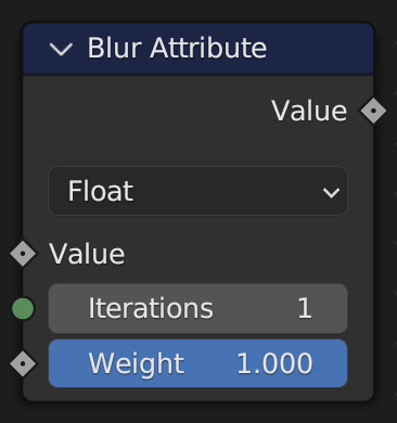

Wert
The immediate value of each primitive to blur.
Iterations
Number of repetitions of mixing value with neighbors. Each iteration is independent. Until one iteration is completed, its results are not used as a source for next blurring.
Weight
Weight of each primitive.
Data Type
The data type used for the evaluated data.
Wert
Values, mixed with neighbors defined number of times.

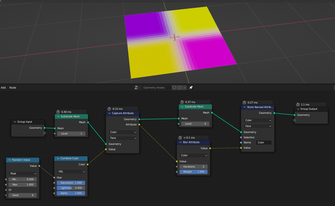

../../../_images/modeling_geometry-nodes_blur_attribute-attribute_example.png
Input is Mesh Plane. First Subdivide Mesh Node add some faces for capture color with Random Value Node used as hue in Combine Color Node on this. Now second Subdivide Mesh Node split each face on a lot of new. Each one new duplicates original attribute. Blur Attribute node mixes all attributes for each face. Due to this, the result is smoothed.
