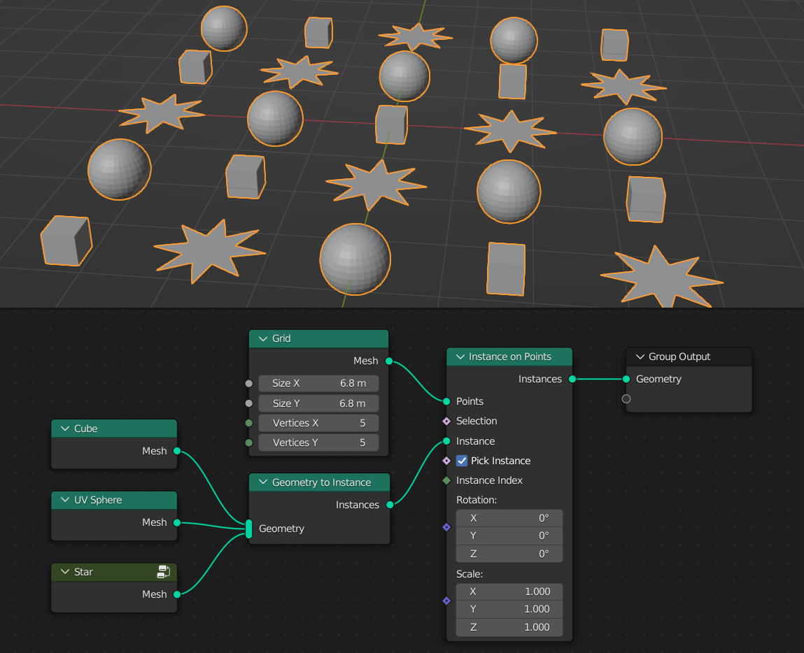

The node used in combination with the Instance on Points Node to choose between multiple primitives for instancing.
