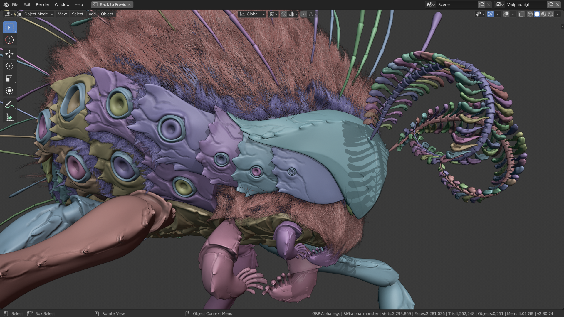

The image below is an excellent example of the Workbench engine’s capabilities using random coloring and shadows to show the details of the model.
../../_images/render_workbench_introduction_example.png
Workbench example.
