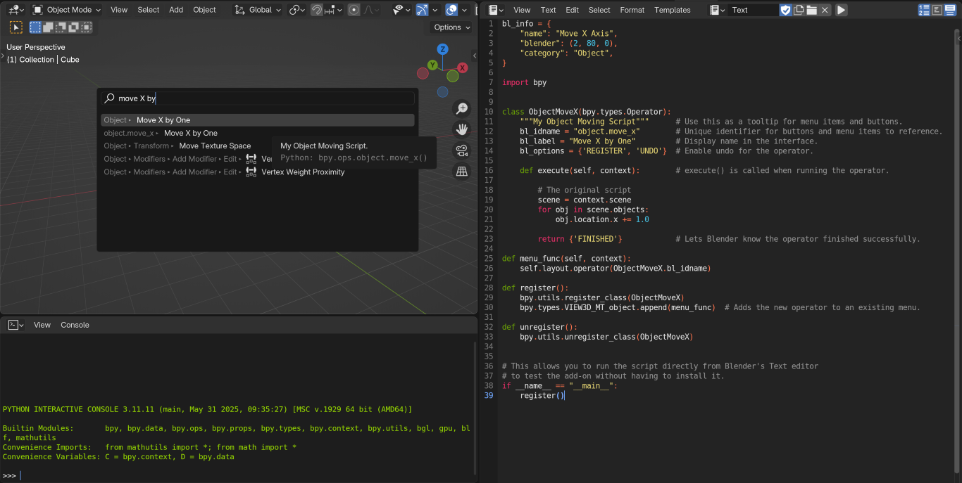

To test the script, you can copy and paste it into Blender’s Text editor and run it. This will execute the script directly and call register immediately.
However running the script won’t move any objects. For this, you need to execute the newly registered operator.
../../_images/advanced_scripting_addon-tutorial_operator-search-menu.png
Operator Search menu.
Open the Operator Search menu and type in “Move X by One” (the bl_label), then Return.
The objects should move as before.
