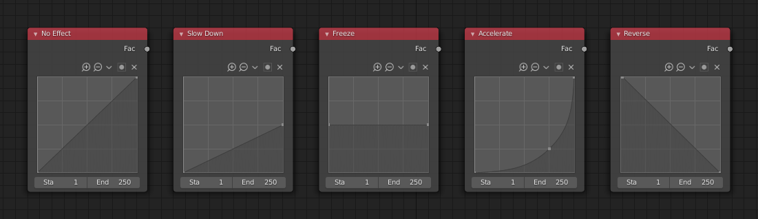

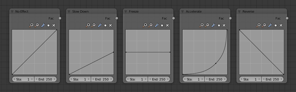

Example
../../../_images/compositing_types_input_time_example.png
Time controls from left to right: no effect, slow down, freeze, accelerate, reverse.
