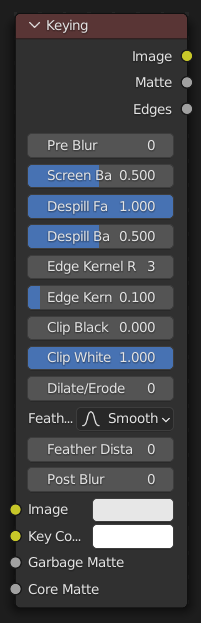

The Keying node is a one-stop-shop for ”green screen” / ”blue screen” removal. It performs both chroma keying to remove the backdrop and despill to correct color cast from the backdrop. Additionally, you can perform common operations used to tweak the resulting matte.
Inputs
Standard color input.
Key Color
The color of content to be removed. This may be a single color, or a reference image such as generated by the Keying Screen Node.
Garbage Matte
An optional mask of area(s) to always exclude from the output. This is removed from the chroma key generated matte.
Core Matte
An optional mask of area(s) to always include in the output. This is merged with the chroma key generated matte.
Properties
Pre Blur
Reduce the effects of color noise in the image by blurring only color by the given amount, leaving luminosity intact. This will affect matte calculation only, not the result image.
Screen Balance
This is the balance between color channels compared with the key color. 0.5 will average the other channels (red and blue in the case of a green screen).
This may be tweaked in tandem with Clip Black and Clip White while checking the Matte output to create a mask with optimal separation.
Despill Factor
Controls how much color bleed from the key color is removed from the input image: 0 means no despilling, 1 means all possible spilling will be removed. The underlying implementation is the same as adjusting the Unspill amount of the Color Spill Node.
Despill Balance
This controls how the color channels are compared when computing spill, affecting the hue and shade of the corrected colors. It is similar to setting the Limiting Channel in the Color Spill Node.
Edge Kernel Radius
Defines the radius in pixel used to detect an edge.
Edge Kernel Tolerance
Defines threshold used to check if pixels in radius are the same as current pixel: if the difference between pixel colors is higher than this threshold then the point will be considered an edge.
Clip Black
This sets the threshold for what becomes fully transparent in the output (black in the matte). It should be set as low as possible. Uneven backdrops will require this value to be increased. Use of the Keying Screen Node can help keep this value low. You may also use a Garbage Matte to exclude problematic areas.
This value does not impact areas detected as edges to ensure edge detail is preserved.
Clip White
This sets the threshold for what becomes fully opaque in the output (white in the matte). It should be set as high as possible. Colors close to green in the foreground may require reducing this value and/or adjusting the Screen Balance. Particularly problematic parts can fixed with a Core Matte instead of a low Clip White.
Dilate/Erode
Enlarge (positive numbers) or shrink (negative numbers) the matte by the specified number of pixels. This is similar to using the Dilate/Erode Node on the matte.
This a simple way to include more or less along the edges of the matte, particularly combined with Post Blur.
Feather Falloff
The rate of the falloff at the edges of the matte when feathering, to manage edge detail.
Feather Distance
Controls how much the matte is feathered inwards (negative number) or outwards (positive number).
Post Blur
Make the matte less sharp, for smoother transitions to the background and noise reduction.
Outputs
Processed image with the Matte applied to the images’ Alpha Channel.
Matte
Output matte to use for checking the quality of the key, or to manually apply using a Set Alpha Node or Mix Node.
Edges
Shows what edges were detected on the matte. Useful for adjusting the Edge Kernel Radius and Edge Kernel Tolerance.
