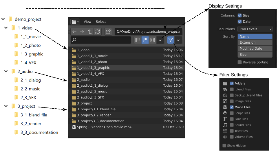

It’s also good practice to use some kind of naming convention and add metadata. Figure 1 shows a possible example, based on our categorization of the assets above. The directories are numbered so that they mimic a normal workflow.
Figure 1: Organizing your project.#
