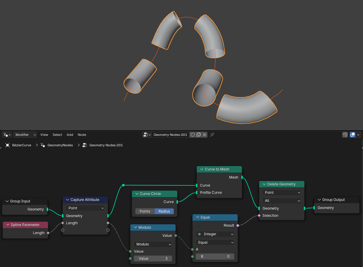

Example
../../../_images/modeling_geometry-nodes_attribute_capture-attribute_example.png
The goal of this example is to turn a Curve into a tube-shaped mesh with pieces cut away at regular intervals. At first, this seems straightforward: use the Curve to Mesh Node to create the tube, read from the Spline Parameter Node to find out where each tube vertex lies on the original curve, and do some math to decide whether to delete the vertex.
This alone doesn’t work, however: the Spline Parameter node calculates its outputs on the fly, and it can only do so for curves. Once the curve has been converted to a mesh, this node can no longer be used.
This is where the Capture Attribute node comes in: it can store the calculated distance on each curve control point. The Curve to Mesh node then transfers these numbers to the mesh vertices (as it does for any attribute). From there, the attribute can be retrieved again by connecting to the same Capture Attribute node that stored it.
