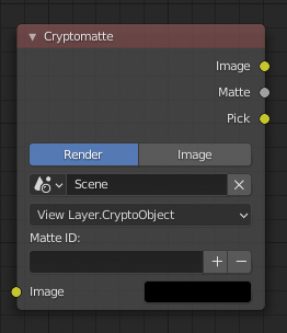

Cryptomatte Node.
The Cryptomatte node uses the Cryptomatte standard to efficiently create mattes for compositing. Cycles and Eevee output the required render passes, which can then be used in the Compositor or another compositor with Cryptomatte support to create masks for specified objects.
Unlike the Material and Object Index passes, the objects to isolate are selected in compositing, and mattes will be anti-aliased and take into account effects like motion blur and transparency.

Properti
Source
The source of the Cryptomatte data.
Render
Use Cryptomatte data that are stored as part of the render.
Use Cryptomatte data that are stored inside a multilayered OpenEXR image.
Scene
Scene selector. Only available when Render Source is selected.
Image selector. Only available when Image Source is selected.
Cryptomatte Layer
Selector of the Cryptomatte layer.
Matte ID
List of object and material crypto IDs to include in matte. This can be used for example to quickly clear all mattes by deleting the text or used to copy-and-paste crypto IDs from other software.
Outputs
A colored output of the input image with the matte applied to only include selected layers.
Matte
A black-and-white alpha mask of all the selected crypto layers.
Pick
A colored representation of the Cryptomatte pass which can be used as a higher contrast image for color picking.
