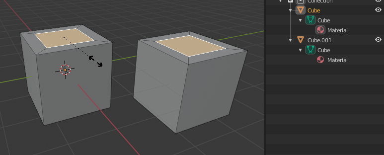

The Cube object was duplicated.
The object Cube was duplicated, using Shift-D. Both these cubes have
separate meshes with unique names: Cube and Cube.001.
- The original left cube is being edited, the duplicated right cube remains unchanged. The mesh data has been copied, not linked.
- Likewise, if one cube is edited in Object Mode, the other cube remains unchanged. The new object’s transform properties or data-block is a copy, not linked.
- When the cube was duplicated, it inherited the material of the original cube. The material properties were linked, not copied.
