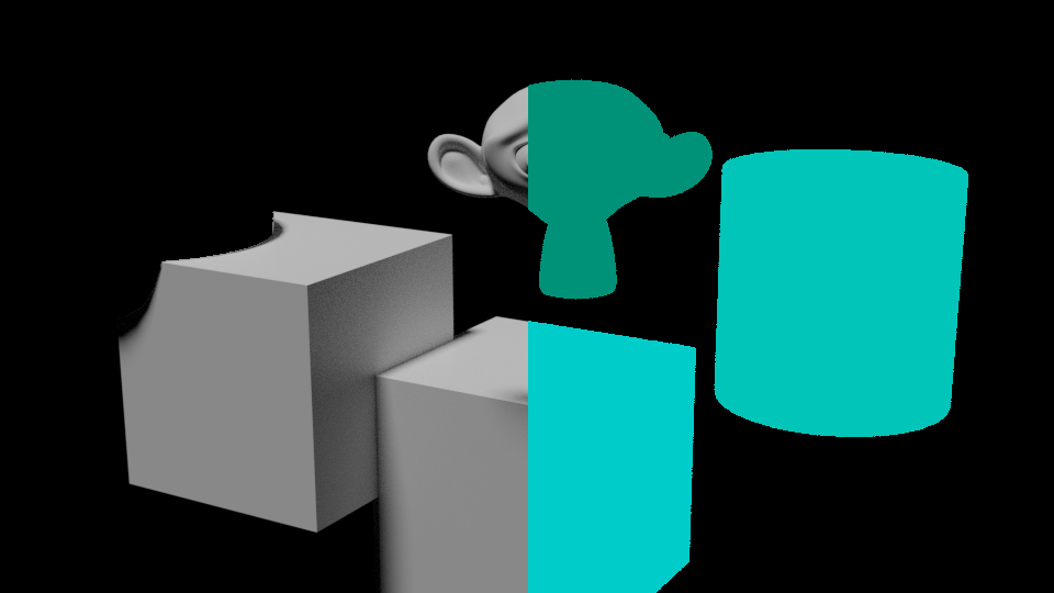

Esempio
In the example below, you can see the pass output on the right side. On the left side you can see a couple of objects that were selected through the Cryptomatte node. Notice how the cube on the left has a sphere shaped cut-out from a sphere that was not selected in the node.
