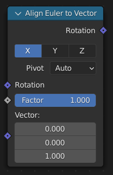

The Align Euler to Vector node.
The Align Euler to Vector node rotates an Euler rotation into the given direction.
Ingressi
- Rotazione
The Euler rotation to align.
Importante
This input has to be a rotation input. Be careful not to connect a direction vector like the normal.
- Fattore
Determines how much the points are rotated towards the vector. Zero effectively disables the node and one means that the points are aligned with the vector perfectly.
- Vector
The direction vector that points should be rotated to. The vector is in the local space of the object that is being modified. When it is all zeros for a point, it is not rotated at all.
Proprietà
- Asse
Local axis of the object that is to be rotated towards the vector input.
- Perno
The local axis to rotate around.
- Auto
The best rotation angle is computed automatically. This minimizes the angle of rotation.
- X, Y, Z
Rotate around a specific local axis.
Uscite
- Rotazione
The rotated Euler rotation.
