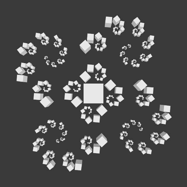

Fractal
Multi-level array animated with motion blur. |
Fractal created with multiple arrays. Sample blend-file. |
