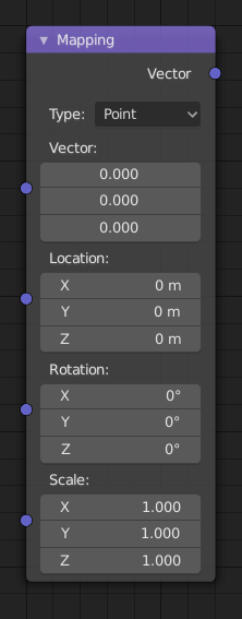

Mapping Node
The Mapping node transforms the input vector by applying translation, rotation, and scaling.
Mapping node.

The inputs of the node are dynamic. In particular, the Location input is only available in the Texture and Point vector types.
- Vector
The vector to be transformed.
- Posizione
The amount of translation along each axis.
- Rotazione
The amount of rotation along each axis. XYZ order.
- Scala
The amount of scaling along each axis.
