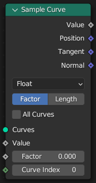

The Sample Curve calculates a point on a curve at a certain distance from the start of the curve, specified by the length or factor inputs. It also outputs data retrieved from that position on the curve. The sampled values are linearly interpolated from the values at the evaluated curve points at each side of the sampled point.
Nota
When the curve contains multiple splines, the sample position is found based on the total accumulated length, including the lengths of all previous splines. The order of the splines is the same order as displayed in the Spreadsheet Editor.

Curve
Standard geometry input with a curve component.
Ingresso
A field input to evaluate custom attributes. The evaluation is outputted through the Value output.
Factor Factor mode
The portion of the total length used to determine the sample position.
Length Length mode
A length in distance units used to determine how far along the curve to travel before sampling.
Curve Index
An index to only evaluate specific splines, these indices can be specified manually or from the Index Node. This input is ignored when the All Curves property is enabled.

Data Type
The data type used for the evaluated data.

All Curves
Sample lengths based on the total length of all curves, rather than using a length inside each selected curve.

Valore
The value of the input Value at the sample point.
Posizione
The position at the sample along the spline.
Tangente
The normalized curve tangent at the sample.

Normale
The normalized curve normal at the sample.
