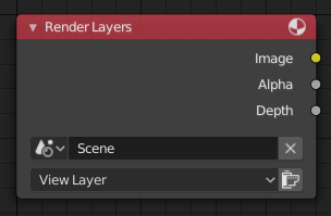

Render Layers Node
../../../_images/compositing_node-types_CompositorNodeRLayers.png
Render Layers Node.
This node is the starting place for getting a picture of your scene into the compositing node map.

Scene
Select the scene within your blend-file. The scene information taken is the raw footage (pre-compositing and pre-sequencing).
힌트
To use composited footage from another scene, it has to be rendered into a multi-layer frameset (e.g. OpenEXR) as an intermediate file store and then imported with Image input node again.
Render layer
A list of available Render Layers. The render button is a short hand to re-render the active scene.
Outputs
Rendered image.
Alpha
Alpha channel.
Render passes sockets
Depending on the Render passes that are enabled, other sockets are available. See Cycles render passes.
Z
By default the Z depth pass is enabled.
