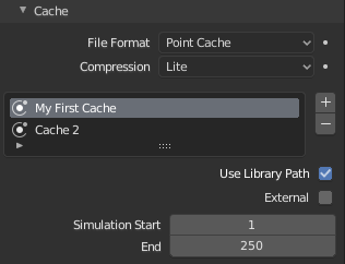

Two different caches stored simultaneously.¶
- Caches List
Blender allows for storing and managing multiple caches at once for the same physics object. You can manage the caches with this list view. Double-click the cache entry to give it a name.
