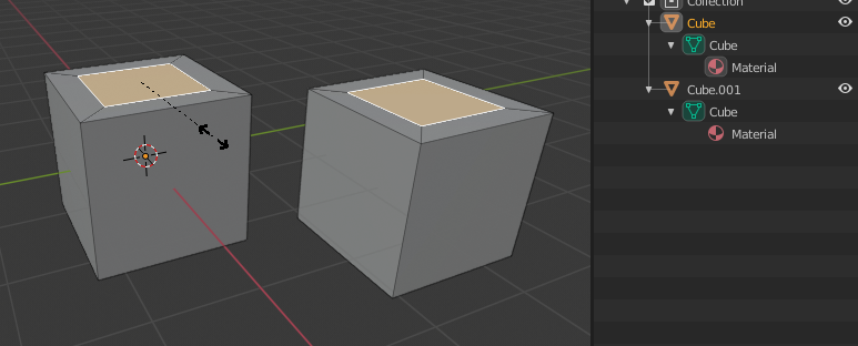

Examples¶
The Cube object was duplicated.¶
The object Cube was duplicated, using Shift-D. Both these cubes have
separate meshes with unique names: Cube and Cube.001.
The original left cube is being edited, the duplicated right cube remains unchanged. The mesh data has been copied, not linked.
Likewise, if one cube is edited in Object Mode, the other cube remains unchanged. The new object’s transform properties or data-block is a copy, not linked.
When the cube was duplicated, it inherited the material of the original cube. The material properties were linked, not copied.
See above if you want separate copies of the data-blocks normally linked.
