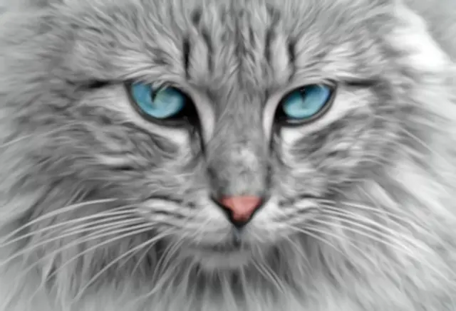

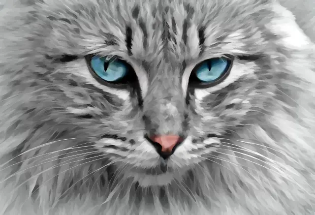

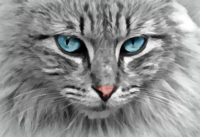

Size
Controls the size of the smoothing neighborhood. Large values may introduce artifacts for highly detailed areas. For the anisotropic method, the larger the size, the slower the filter.
../../../_images/compositing_types_filter_kuwahara-node_original.webp
Original.
../../../_images/compositing_types_filter_kuwahara-node_size3.webp
../../../_images/compositing_types_filter_kuwahara-node_size6.webp
../../../_images/compositing_types_filter_kuwahara-node_size9.webp
Original.
../../../_images/compositing_types_filter_kuwahara-node_sharpness0.webp
Sharpness: 0.
../../../_images/compositing_types_filter_kuwahara-node_sharpness05.webp
Sharpness: 0.5.
../../../_images/compositing_types_filter_kuwahara-node_sharpness1.webp
Sharpness: 1.
Eccentricity
Controls how thin and directional the filter is. Low eccentricity corresponds to circular omnidirectional features while high eccentricity corresponds to thin directional features.
Original.
../../../_images/compositing_types_filter_kuwahara-node_eccentricity0.webp
Eccentricity: 0.
../../../_images/compositing_types_filter_kuwahara-node_eccentricity1.webp
Eccentricity: 1.
../../../_images/compositing_types_filter_kuwahara-node_eccentricity2.webp
Eccentricity: 2.

Iterations
The filter can be applied multiple times by chaining the node multiple times. This chaining can produce more flat filtering.
Original.
../../../_images/compositing_types_filter_kuwahara-node_iterations1.webp
Iterations: 1.
../../../_images/compositing_types_filter_kuwahara-node_iterations2.webp
Iterations: 2.
../../../_images/compositing_types_filter_kuwahara-node_iterations3.webp
Iterations: 3.
