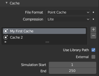

Two different caches stored simultaneously.¶
- Caches List
Blender allows for storing and managing multiple caches at once for the same physics object. You can manage the caches with this list view. Double-click the cache entry to give it a name.
Options¶
- Cache Name
Each cache can have a name. If this name is given, any disk cache will be stored in files starting with that name. For example, a cache named ’MyCache’ will be stored in
MyCache_xxxxxx_yy.bphys.If the cache does not have a name (which is the default), the filename of the cache will depend on the object it is attached to, although this is not immediately obvious. For example, a cache on an object
Cubewill be stored in43756265_xxxxxx_yy.bphys, where43756265is determined by the object name.Advarsel
When there are multiple caches on one object, always specify a Cache Name. As described above, the filename of an unnamed cache is determined by the name of the object it is attached to. As a result, an object with multiple physics systems that all have an unnamed cache will cause conflict and can result in losing cache files.

The cache of a baked simulation will be stored inside the blend-file when you save it. When Disk Cache is checked, Blender will save the cache separately to the drive in a folder named
blendcache_[filename]alongside the blend-file. (The blend-file must be saved first.)- Use Library Path
Share the disk cache when the physics object is linked into another blend-file.
When this option is enabled, linked versions of the object will reference the same disk cache. Otherwise linked versions of the object will use independent caches.

- Start
Frame on which to start the simulation.
- End
Frame on which to stop the simulation.
Obs
The simulation is only calculated for positive frames in between the Start and End frames of the Cache panel, whether you bake or not. So if you want a simulation that is longer than the default frame range you have to change the End frame.
