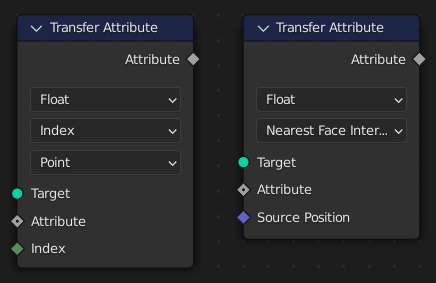

Transfer Attribute Node
../../../_images/modeling_geometry-nodes_attribute_transfer-attribute_node.png
Transfer Attribute node.
The Transfer Attribute node retrieves values from a target geometry and provides them as a field, so they can be used anywhere.
