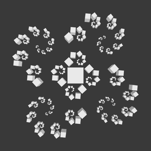

Fractal
../../../_images/modeling_modifiers_generate_array_example-fractal-1.jpg
Multi-level array animated with motion blur.
../../../_images/modeling_modifiers_generate_array_example-fractal-2.png
Fractal created with multiple arrays. Sample blend-file.
