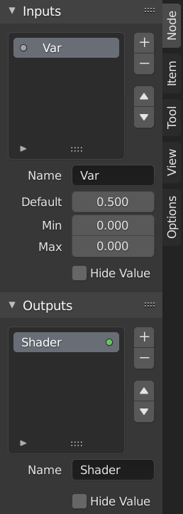

../../../_images/interface_controls_nodes_groups_interface-panel.png
The interface panel for editing groups.
Sockets can be added, re-ordered, or removed, descriptive names can be added and the details of the input data value defined here.
If you have multiple inputs or outputs, they can be re-ordered by selecting the socket in the list. and then moving them up or down with the arrow buttons on the right side of the panel. The plus button will add an unconnected socket of the same type as the selected socket or a value socket if there is no selection. The minus button will remove the selected socket. The triangle at the bottom of the list has filtering functions to help finding nodes if the group has a large number of sockets.
Name
The name of the socket to display in the node’s interface.
Default
The value to use when nothing is connected to the node socket. Note, this will not affect the current node but will affect instances of the node.
Min, Max
The minimum and maximum value for the UI button shown in the node interface. Note, this is not a minimum or maximum for the data that can pass through the node. If a socket passes a higher value than the maximum it will still pass into the node unchanged.
Hide Value
Hide the socket value even when the socket is not connected.
