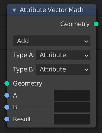

Attribute Vector Math¶
Modify an attribute with a math operation.
The Attribute Vector Math Node.¶
Inputs¶
- Geometry
Standard geometry input.
- A, B, C
The inputs to the math operations. Depending on the operation one, two, or all three of the inputs will be used. The attribute types are all vectors of three values, except for the Scale operation, where the second input uses a float type.
- Result
The name of the attribute where the computed result it stored. A new attribute with that name is added if it does not exist yet. If it does exist, the values of the existing attribute are overridden.
Properties¶
- Operation
The math function to perform.
