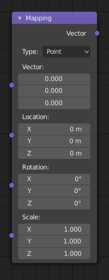

Nó Mapeamento¶
The Mapping node transforms the input vector by applying translation, rotation, and scaling.
Nó Mapeamento.¶
Entradas¶
The inputs of the node are dynamic. In particular, the Location input is only available in the Texture and Point vector types.

Propriedades¶
- Vector Type
The node applies the transformation differently depending on the semantic type of the input vector.
