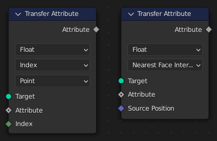

Transfer Attribute Node
../../../_images/modeling_geometry-nodes_attribute_transfer-attribute_node.png
Transfer Attribute node.
The Transfer Attribute node retrieves values from a source geometry and provides them as a field, so they can be used anywhere.

Properties
Domínio
The attribute domain that the attribute is transferred from, or in other words, the domain used to evaluate the Attribute input. For example, it is possible to transfer data from the faces of one geometry to the points of another.
Mapeamento
How elements from the destination geometry are mapped to the output.
Índice
Copy the attribute data from the value at the input index. In this mode, the source geometry can consist of a mesh, point cloud, or curve. The matching component type from the context will be chosen if possible, otherwise a component will be chosen in that order.
Nearest Face Interpolated
Transfer the attribute from the nearest point from anywhere on the surface. Non-face attributes are interpolated across the surface (edge attributes are not supported yet). Loose points and edges are ignored.
Mais próximo
Transfer the attribute from the nearest element (with a domain chosen by the Domain input). No interpolation is done.
