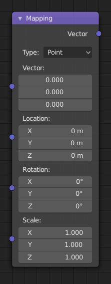

Nó Mapeamento
The Mapping node transforms the input vector by applying translation, rotation, and scaling.
Nó Mapeamento.
