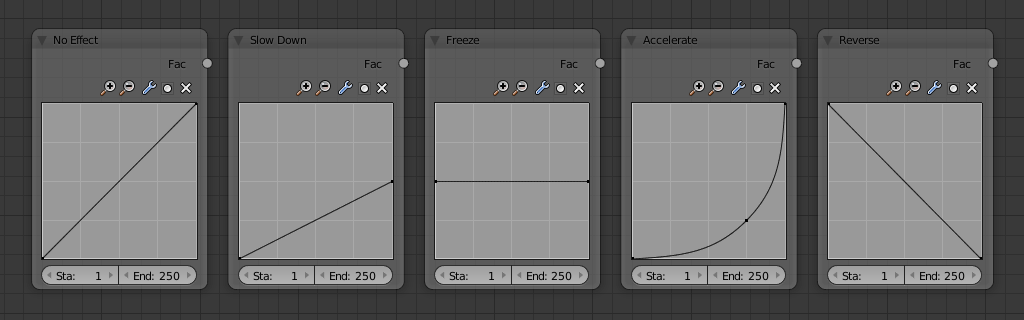

The Time node generates a factor value (from 0.0 to 1.0) that changes according to the curve as time progresses through the Timeline.

- Curve
The Y value defined by the curve is the factor output. For the curve controls see: Curve widget.

- Start, End
- Start frame and End frame of the range of time specifying the values the output should last. This range becomes the X axis of the graph. The time input could be reversed by specifying a start frame greater than the end frame.

- Factor
- A speed of time factor (from 0.00 to 1.00) relative to the frame rate defined in the Render Dimensions Panel. The factor changes according to the defined curve.
