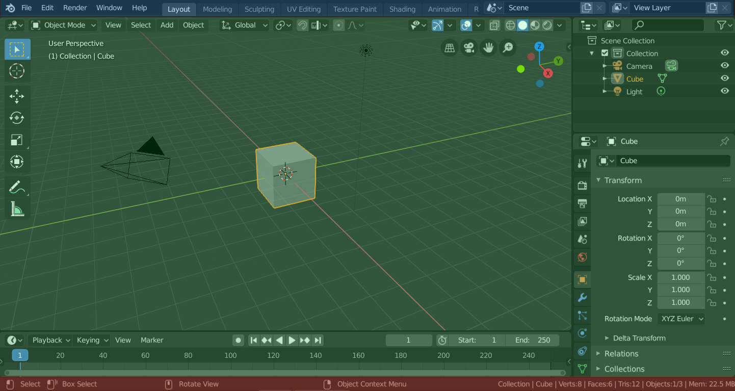

After starting Blender and closing the Splash Screen the Blender window should look something similar to the image below; as Blender’s user interface is consistent across all platforms.
Стартовая сцена Blender’а по умолчанию.¶
Blender’s interface is separated into three main parts:
Topbar at the very top.
Areas in the middle.
Status Bar at the bottom.
Blender’s default Screen Layout. Topbar (blue), Areas (green) and Status Bar (red).¶
