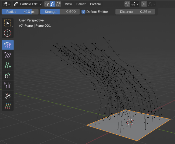

Setup for Hair Particles
  1. Create a Hair particle system.
  2. Give it an initial velocity in the Normal direction.
  3. Create a simulation.
  4. Check the Hair Dynamics box.
../../_images/physics_particles_mode_example.png
Editing hair strands in Particle Edit Mode.
