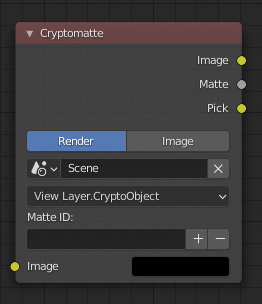

Nút Lớp Lồng Bí Mật.
The Cryptomatte node uses the Cryptomatte standard to efficiently create mattes for compositing. Cycles and Eevee output the required render passes, which can then be used in the Compositor or another compositor with Cryptomatte support to create masks for specified objects.

Tính Chất (Properties)
Nguồn (Source)
The source of the Cryptomatte data.
Render (Kết Xuất)
Use Cryptomatte data that are stored as part of the render.
Hình Ảnh (Image)
Use Cryptomatte data that are stored inside a multilayered OpenEXR image.
Cảnh (Scene)
Scene selector. Only available when Render Source is selected.
Hình Ảnh (Image)
Image selector. Only available when Image Source is selected.
Tầng Lớp Lồng Bí Mật (Cryptomatte Layer)
Selector of the Cryptomatte layer.
ID của Lớp Lồng (Matte ID)
List of object and material crypto IDs to include in matte. This can be used for example to quickly clear all mattes by deleting the text or used to copy-and-paste crypto IDs from other software.
