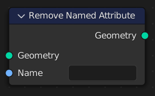

The Remove Named Attribute node deletes an attribute with a certain name from its geometry input. Any attribute that exists on geometry data will be automatically propagated when the it is changed, which can be an expensive operation, so using this node can be a simple way to optimize the performance of a geometry node tree or even to lower the memory usage of the entire scene.
Almost all attribute names can be removed. For certain Thuộc Tính Gắn Sẵn (Built-In Attributes), removing it will mean that a default value will be used instead. For example, removing the cyclic attribute on curves means that all curves will be non-cyclic.
