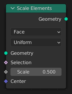

Scale Elements Node
../../../_images/modeling_geometry-nodes_scale-elements_node.png
The Scale Elements node.
The Scale Elements Node scales groups of connected edges and faces. When multiple selected faces/edges share the same vertices, they are scaled together. The center and scaling factor is averaged in this case.
輸入
Mesh
Standard geometry input.
Selection
Whether to scale each edge or face. True values mean the element will be scaled, false means it will be unaffected.
Scale
The factor used to scale elements or groups of elements.
Center
Origin of the scaling for each element. If multiple elements are connected, their center is averaged.
Direction Single Axis Mode Only
Direction in which to scale the element. This input is normalized internally, so the length does not matter.
屬性
Domain
The element type to transform.
Face
Scale individual faces or neighboring face islands.
Edge
Scale individual edges or neighboring edge islands.
Scale Mode
Uniform
Scale elements by the same factor in every direction.
Single Axis
Scale elements in a single direction defined by the Direction input.
Output
Mesh
Standard geometry output.
