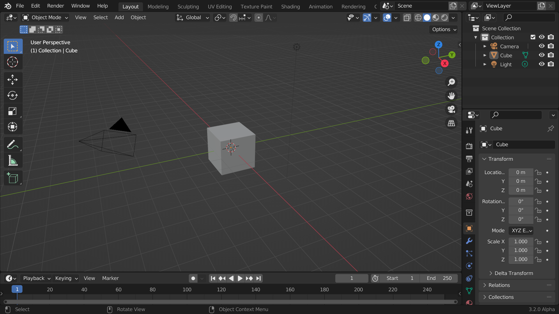

After starting Blender and closing the Splash Screen, the Blender window should look similar to the image below.
The default startup Blender window.#
Blender's interface is separated into three main parts:
The Topbar at the very top, consists of the main menu, which is used for saving, importing and exporting files, configuring settings, and rendering among other functions.
Areas in the middle, which is the main workspace
The Status Bar at the bottom, which displays shortcut suggestions and relevant statistics.
