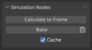

- Calculate to Frame
Calculate simulations in geometry nodes modifiers from the start to current frame.
- Bake
Bake simulations in geometry nodes modifiers. In order to bake the simulation, the blend-file must be saved to your computer. The location the file is saved determines where the baked data is also saved. The directory the baked data is saved to can be changed per modifier in the Internal Dependencies.
- Delete Cached Simulation
Delete cached/baked simulations in geometry nodes modifiers
- Cache
For the cases where the current frame is the only one relevant, users can opt-out of caching the results to save memory.
