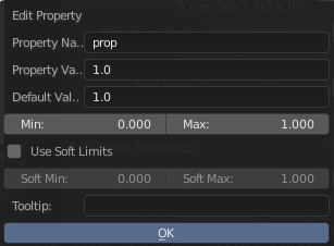

Custom Properties edit pop-up.
- Property Name
- The name of the custom property.
- Property Value
This does two things: first it sets the current value of the custom property, and second, it defines the data type of the property. Custom properties can be of the following types: Integers, Floats, Strings or Booleans. See the table below for a list of examples for each:
Integers: 1, 2, 3, 4, Floats: 3.141, 5.0, 6.125, Strings: any text, Booleans: True,FalseBemerkung
Booleans are handled very similar to integers and only work when using Min/Max values that are integers and that are no more than 1 apart.
At this point, the booleans will still look like integers but behave like booleans having one lower, off, value and a higher, on, value.
- Default Value
This sets the default value of the property used by the Reset to Default Value operator.
Warnung
Default values are used as the basis of NLA blending, and a nonsensical default (e.g. 0 for a property used for scaling) on a property intended for being keyframed is likely to cause issues.
- Min
- The minimum value the custom property can take.
- Max
- The maximum value the custom property can take.
- Use Soft Limits
Enables limits that the Property Value slider can be adjusted to without having to input the value numerically.
- Soft Min
- The minimum value for the soft limit.
- Soft Max
- The maximum value for the soft limit.
- Tooltip
- Allows you to write a custom Tooltip for your property.
