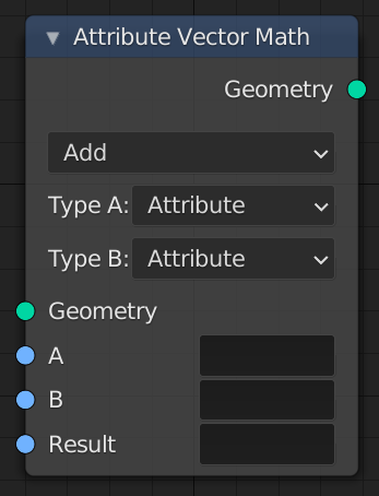

Attribute Vector Math
Modify an attribute with a math operation.
../../../_images/modeling_modifiers_nodes_attribute-vector-math.png
The Attribute Vector Math Node.
