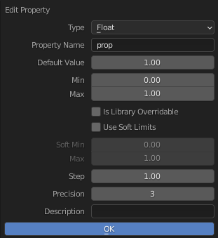

Editing Properties
Benutzeroberfläche
Custom Properties edit pop-up.
Custom properties can be edited using the panel available for data types that support it. Editing the properties allows you to configure things such as default values, ranges, and even add a custom tooltip.
- Type
The data type of the property; different data types have can only have specific data properties.
- Float
A numeric value with decimals e.g. 3.141, 5.0, or 6.125.
- Float Array
A collection of multiple float data types e.g.
[3.141, 5.0, 6.125]. This data type can also be used for data that can be represented as a float array such as colors. These special float arrays can be set in the Subtype selector.- Integer
A numeric value without any decimals e.g. 1, 2, 3, or 4.
- Integer Array
A collection of multiple integer data types e.g.
[1, 2, 3, 4].- String
A sequence of characters such as „Some Text“.
- Python
Edit a Python data type directly, used for unsupported data types.
Bemerkung
Boolean values must be handled as integers and only work when using Min/Max values that are integers and that are no more than 1 apart.
At this point, the Boolean values will still look like integers but behave like a Boolean having one lower, off, value and a higher, on, value.
- Array Length
The number of elements in the array. Note that if the array length is greater than 7 you cannot directly edit its elements, you must press Edit Value to edit the elements of the array.
- Property Name
The text that is displayed to the left of the value. This name is also used to access the property via Python.
- Default Value
This sets the default value of the property used by the Reset to Default Value operator.
Warnung
Default values are used as the basis of NLA blending, and a nonsensical default (e.g. 0 for a property used for scaling) on a property intended for being keyframed is likely to cause issues.
- Min, Max
The minimum/maximum value the custom property can take.
- Is Library Overridable
Allow the property to be overridden when the data-block is linked.
- Use Soft Limits
Enables limits that the Property Value slider can be adjusted to without having to input the value numerically.
- Soft Min, Max
The minimum/maximum value for the soft limit.
- Step
A multiplier to control how much the data type is incremented at a time. The internal step size for floats is 0.01, so a Step value of 5 will increment at a rate of 0.05 and a Step value of 100 will increment by 1.0. For integers the internal step size is 1.
- Precision
The number of digits after the decimal to display in the user interface for float data types.
- Subtype
Specifies the type of data the property contains, which affects how it appears in the user interface. In order for this property to appear the Property Value must be a vector of floats. For either of the color subtypes to work the Property Value must be a vector with three or four values depending on the availability of an Alpha Channel.
- Plane Data
Data values do not have any special behavior.
- Linear Color
Color in linear color space.
- Gamma-Corrected Color
Color in gamma corrected color space.
- Euler Angles
Euler Rotation angles.
- Quaternion Angles
Quaternion Rotation angles.
- Description
Allows you to write a custom Tooltip for your property.
