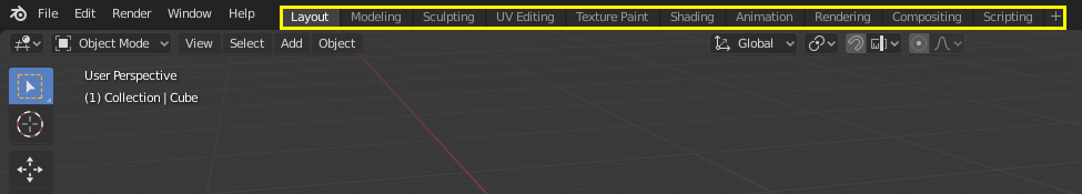

Workspaces are essentially predefined window layouts. Each Workspace consists of a set of Areas containing Editors, and is geared towards a specific task such as modeling, animating, or scripting. You’ll typically switch between multiple Workspaces while working on a project.
../../_images/interface_window-system_workspaces_screen.png
Workspaces are located at the Topbar.

Click on the tabs to switch between the workspaces. You can also use the keyboard shortcuts Ctrl-PageUp and Ctrl-PageDown. Double-click a tab to rename the workspace.

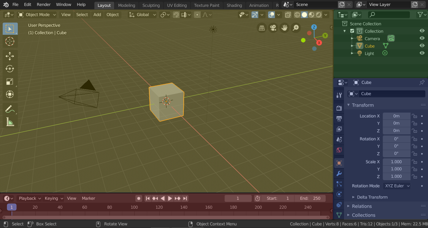

Blender’s default startup shows the „Layout“ workspace in the main area. This workspace is a general workspace to preview your scene and contains the following Editors:
../../_images/interface_window-system_workspaces_layout.png
Blender’s ‚Layout‘ Workspace with four editors.
3D Viewport (yellow), Outliner (green), Properties (blue) and Timeline (red).
