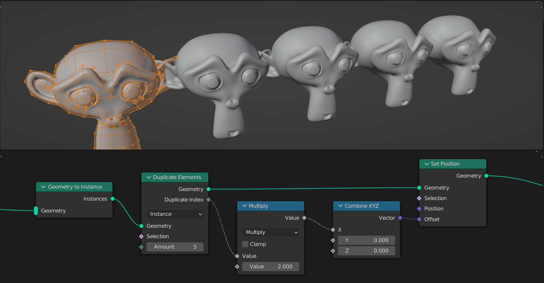

../../../../_images/modeling_geometry-nodes_geometry_duplicate-elements_instance.png
Combined with the Geometry to Instance Node, this can be used to create a basic efficient „Array“ operation. This should be more efficient because the duplicates are instances.
The „Duplicate Index“ is used to move each instance in the result a different amount.
